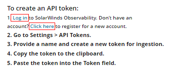

  6. If you have a SolarWinds Observability SaaS account, click the Log in link on the Create Account/Configure Token page to open SolarWinds Observability SaaS. Then continue with the next step.

    1. Click the Click here link on the Create Account/Configure Token page.

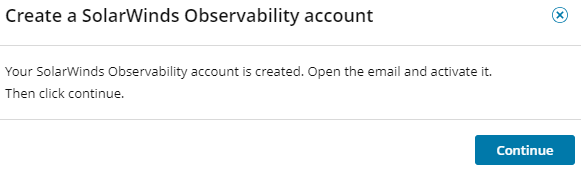

      The Create a SolarWinds Observability account dialog opens.
    2. Enter your information and select a Cloud Provider. Then click Create.
      A message tells you that your account has been created.

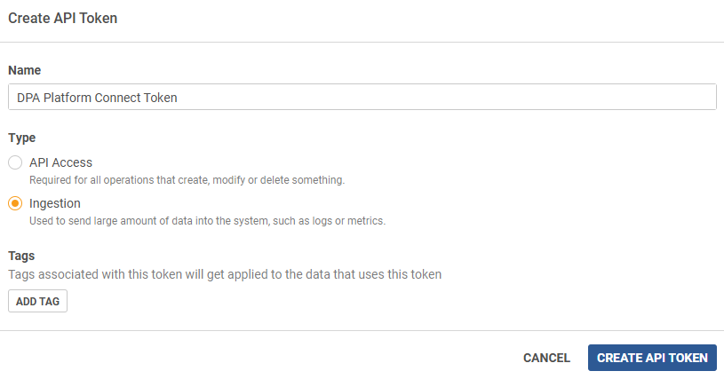

  7. In the SolarWinds Observability SaaS left menu, click Settings.
  8. In the My Settings menu, click API Tokens.
  9. Click Create API Token.
  10. Enter a name, verify that Ingestion is selected, and click Create API Token.
    A dialog displays the API token.
  11. Click the clipboard icon to copy the token to the clipboard. Then click Close.
  12. Return to the browser tab in which DPA is running. On the Create a SolarWinds Observability account dialog, click Continue to close the dialog.

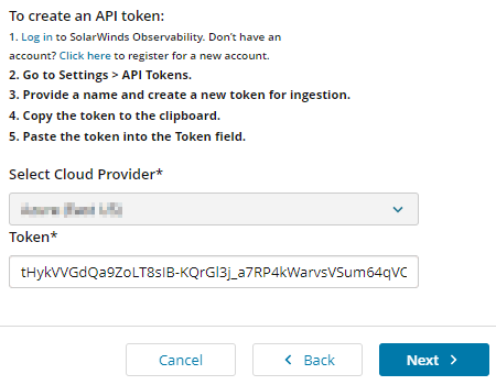

  13. Select a cloud provider, and paste the copied token into the Token field. Then click Next.
    The Install Agent page opens.
