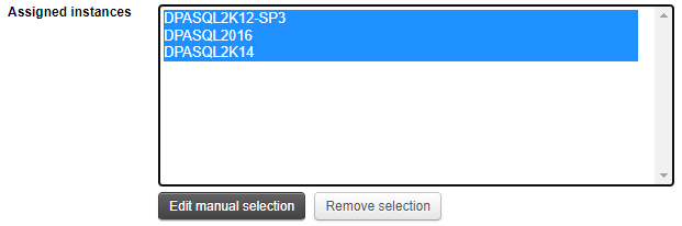

  2. To change the assigned instances, do either of the following:
    • If the instances were manually selected, click the Edit manual selection button to change the manual selection. Or complete the following steps to remove the manually selected instances and use a rule instead:
      1. In the Assigned instances box, select all instances.
      2. Click Remove selection.

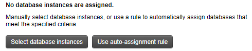

        The option to use a rule becomes available.
      3. Click Use auto-assignment rule.
