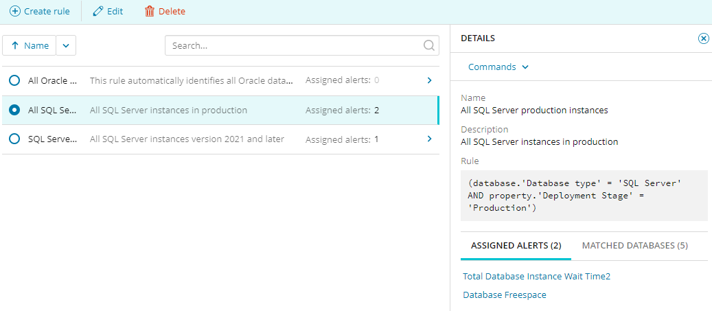

      The Rules page shows information about each existing rule, such as the name, description, and number of alerts that use the rule.
  2. To find the rule you are interested in:
    • Enter a string in the Search text box to search for terms in a rule name or description.
    • Select an option from the drop-down menu above the list to change the sort order. For example, sort by assigned alerts to locate any unused rules. By default, rules are sorted by name.

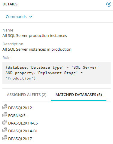

  3. To see additional information about a rule, click the > to the right of "Assigned alerts" on that row.
    The Details pane shows information such as the rule definition and the alerts that use the rule.
  4. Click Matched Databases to see the database instances that meet the rule conditions.

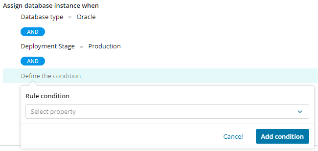

  4. Under Assign database instance, add the first condition:
    1. Click .
    2. Select a database property or a custom property.
    3. Select an operator. Available operators include:
      containsThe selected property must contain the specified value.
      does not containThe selected property must not contain the specified value.
      =The selected property must exactly match the specified value.
      !=The selected property must not match the specified value.
      <=(Numeric properties only.) The selected property must be less than or equal to the specified value.
      >=(Numeric properties only.) The selected property must be greater than or equal to the specified value.
      <(Numeric properties only.) The selected property must be less than the specified value.
      >(Numeric properties only.) The selected property must be greater than the specified value.
    4. Select a value from the drop-down menu, or type a value and click Use user defined value.
    5. Click Add condition.

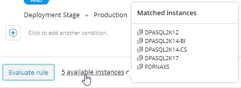

  6. To see how many instances that meet the rule conditions, click Evaluate rule. Hold the mouse pointer over the number to display the list of instances.

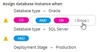

Change the AND operator to an OR operator
When you add an additional condition, the Boolean operator joining the conditions is AND by default. To use an OR operator:
  1. Add an additional condition. The connecting operator is AND.
  2. Click the AND operator. The available operators are displayed to the right.
  3. Click the OR operator. The connecting operator changes to OR.

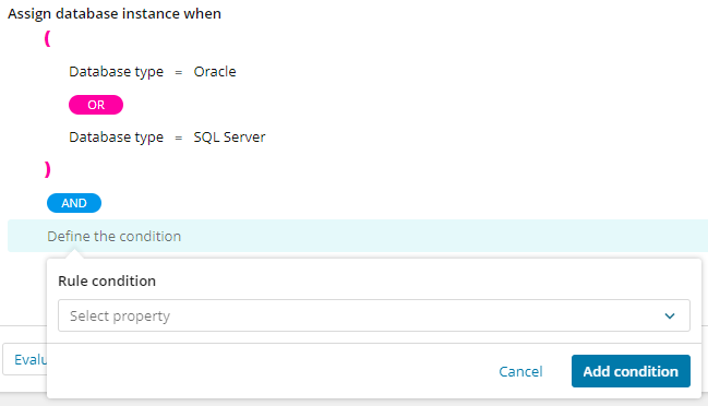

Group and ungroup conditions
Grouped conditions are surrounded by parentheses, and they are evaluated together. For example, the following rule would identify instances that 1) are either Oracle or SQL Server and 2) have a value of Production for the custom property Deployment Stage.
Group conditions
You can group conditions in either of the following ways:
  • If you have two or more conditions, you can automatically group all existing conditions when you add a new condition. Click the below the existing conditions.
    DPA places parentheses around all existing conditions to group them, and the Rule condition dialog box opens.
  • To group a pair of existing conditions without adding a new condition:
    1. Click the operator between the conditions you want to group. Options are displayed on the right.
    2. Click (Group). DPA places parentheses around the conditions to group them.

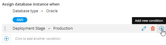

Add a condition without grouping existing conditions
If you have two or more conditions, complete the following steps to add another condition without grouping the existing conditions.
  1. Hold the mouse pointer over any condition.
  2. Click the to the right of the condition.
    The new condition is added below the selected condition, and the existing conditions are not grouped.

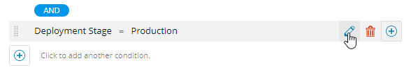

Edit a condition
  1. Hold the mouse pointer over the condition.
  2. Click the pencil icon to the right of the condition.
    The Rule condition dialog box opens.
  3. Change one or more values, and click Edit condition.
