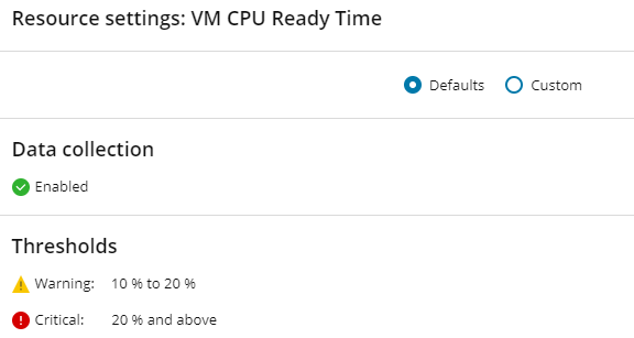

  4. Locate the metric chart and click to the right of the chart.
    The Resource Settings page displays the thresholds that are currently used for this metric.

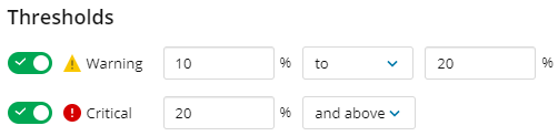

  2. Enter the new threshold values:
    • If the metric does not have default thresholds, click the toggle switch next to each threshold level you want to enable.
    • If you enable both the Warning and Critical threshold levels, enter the same value at the intersection of the two levels:
      • For metrics that alert on higher values, enter the same number as the maximum Warning value and the minimum Critical value.
        DPA issues a Warning alert when the value is within the Warning range (inclusive). DPA issues a Critical alert when the value is greater than the minimum Critical threshold.
        Example: For the thresholds shown in step 1, DPA issues a Warning alert when the value is 10 through 20. DPA issues a Critical alert when the value is greater than 20.
