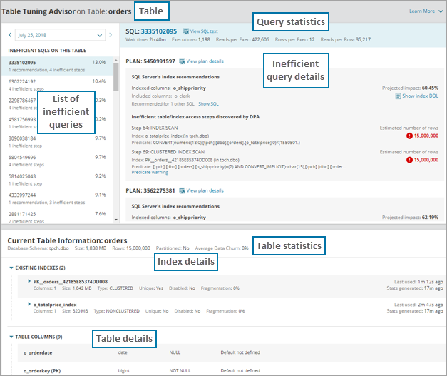

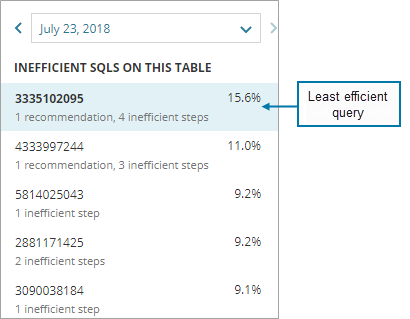

Examine the list of inefficient queries
The upper-left pane lists the inefficient queries that ran against the table on the selected day. DPA assigns a relative efficiency score to each query and uses this score to sort the list.
Select a query from this list to display detailed information about it.
Tips for using this information
  • Focus your tuning efforts on the queries at the top of the list, which are driving the most inefficient workload against this table.
  • A large number of queries in the list could indicate a more widespread performance issue. Perhaps one good index could improve the performance of several similar queries.

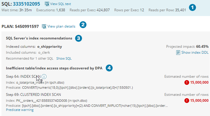

The upper-right pane displays information about the selected query that can help you determine the source of read inefficiencies against this table.
The performance statistics at the top of the pane show the extent of the query's inefficiency:
  • Reads per Exec is the number of read I/O operations per execution, which indicates how much work the query is doing.
  • Rows per Exec is the number of rows the query returns.
  • The Reads per Row ratio is the number of reads the query needed to do to arrive at each row in the query's result set. Statements with the highest Reads per Row ratios could potentially benefit most from tuning.
For more information about the query, click the SQL name or hash value to view DPA's query performance analysis, which shows when the query ran, the execution statistics, and the most relevant metrics charts.
DPA lists each execution plan that it finds. You can click the link to examine the full plan, but DPA lists the steps most likely to need attention below.
(SQL Server and Azure only) Index recommendations made by the SQL Server optimizer, if any, are listed. The Projected Impact is the cost reduction that the optimizer estimates the recommended index will have. Click Show index DDL to see the CREATE INDEX statement for the recommendation.
DPA analyzes the plan and lists steps with the most inefficient access paths.
These steps read data to be processed by subsequent "consumer" plan steps. While consumer steps (for example, sorts) can have a high plan cost, they are usually affected by a preceding step that read too much data.
Information about each step includes:
  • The step number and the type of operation being performed in the step (for example, INDEX SCAN).
  • The index this step uses, if it uses an index.
  • Any predicates. These are snippets of the SQL that the plan step is acting on. They are typically portions of JOIN or WHERE clauses in which a table's column is being compared to another column or value.
  • Any warnings that apply to the step.
  • The number of rows the optimizer estimates this step will read. Critical and warning icons identify steps that read a high percentage of the table or index rows, and therefore have a greater need for tuning or an index.

  • Before you add an index, weigh the projected impact or potential performance improvement against indexing trade-offs. Also consider the indexing needs of other queries.
  • Click any step to get detailed information about the operation and recommendations for potentially reducing the amount of I/O.
  • If predicates are listed, they often indicate which columns need to be indexed, or where the optimizer is not using an existing index. For example, if the query calls a function on the column, the plan will not use an index.
  • If warnings are listed, click the warning for a detailed description of the condition that DPA has identified as a potential reason for concern.
