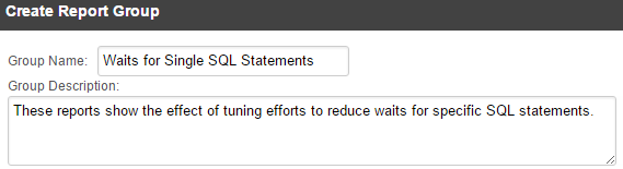

Create a report group
  1. On the DPA menu, click Reports.
  2. Click the Report Groups tab.
  3. Click Create Report Group.
  4. Give the group a name and (optionally) a description.

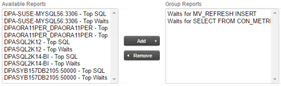

  5. Select the reports to include in this group and click Add.
  6. Click OK, and then click OK at the confirmation message.
    This group is added to the list of report groups.

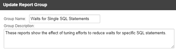

Edit a report group
  3. Click the name of the report to open the Update Report Group dialog.
  4. Select the reports you want to add or remove, and then click the Add or Remove button.
  5. Click OK, and then click OK at the confirmation message.
    This group is updated.
