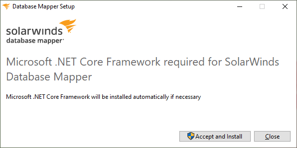

The first part of the installation process ensures that you have the Microsoft .NET Core Framework required for Database Mapper Software. It installs Windows Server Hosting (if necessary).
- Execute SolarWinds-DatabaseMapper-Host-<Version>.exe on the machine where you want to install the web client to get started.
- Select Accept and Install to continue.

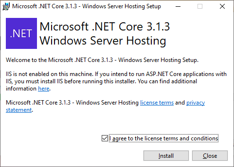

- You may need to install Windows Server Hosting (if so, you'll see a series of popups similar to the ones below). Select the box next to I agree to the license terms and conditions, then select Install, wait for the installation to complete, and then select Close.
- The Setup Progress window will remain open while the installation continues.

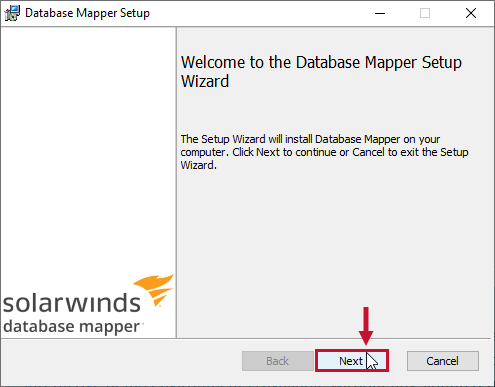

- Select Next on the Database Mapper Setup screen.

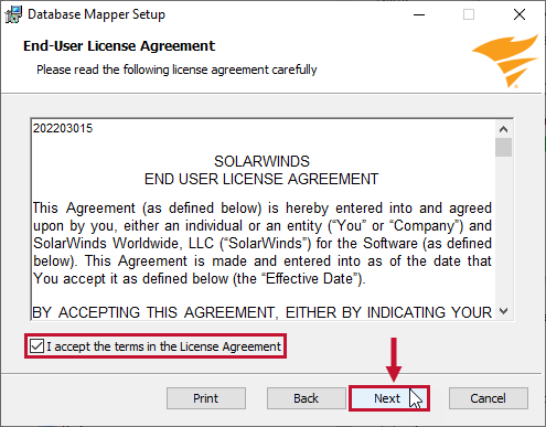

- Select the box next to I accept the terms in the License Agreement, then select Next.

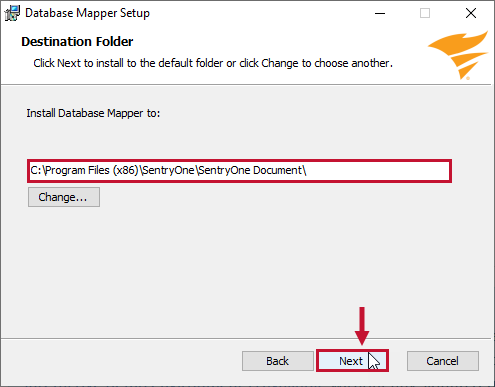

- Accept the default destination folder for installation, or use Change to specify a non-default location, then select Next.

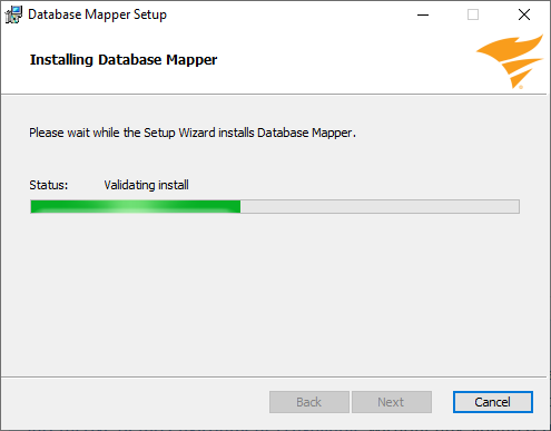

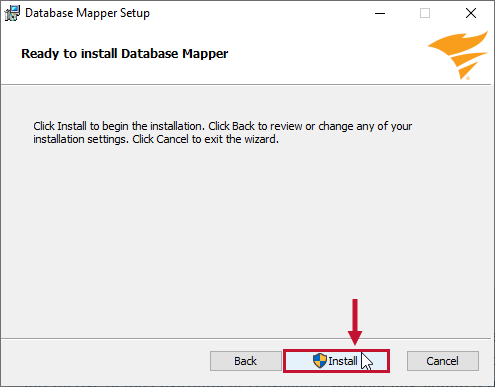

- Select Install to begin the installation with the configured settings. You can select Back to change any settings or select Cancel to exit the process without installing Database Mapper.
- The installation process will proceed.

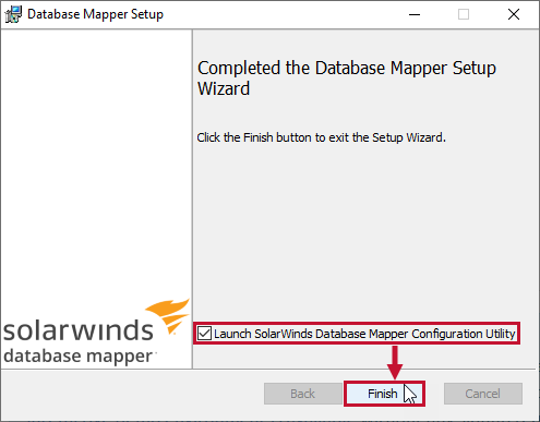

- The web client for Database Mapper has been installed. Select Finish to complete the process, and launch the Database Mapper Configuration Utility.

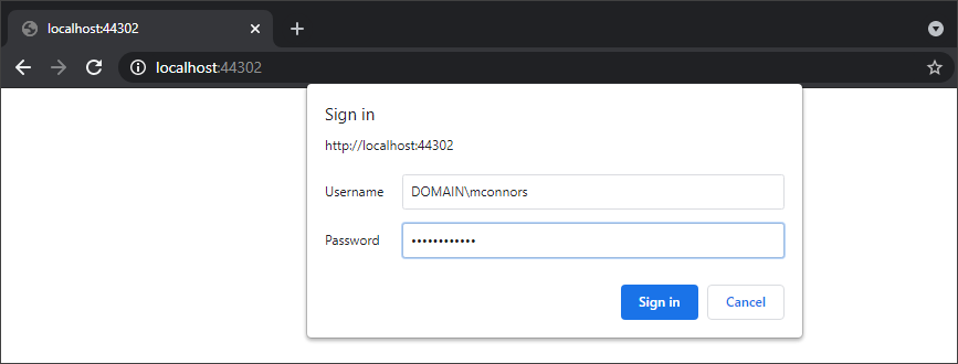

- Navigate to your server:port (In this example, it is http://localhost:44302)
- Log in using your Windows credentials. Note: You may need to use the format DOMAIN\User name (depending on your environment).
- Enter your Username and Password on the second Sign in screen for port 44322.
