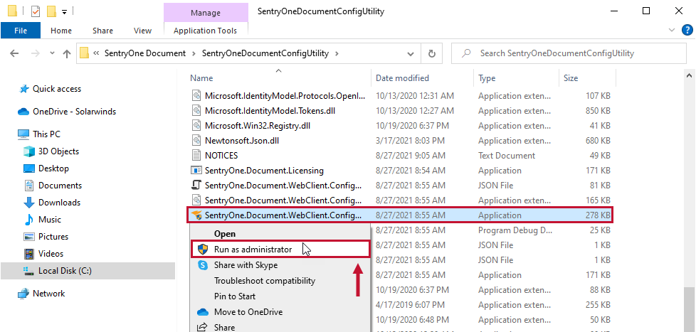

Database Mapper Configuration Utility Run as administrator
File path:
  1. Navigate to the SentryOne DocumentConfigUtility directory in your Database Mapper Software installation. The default path is C:\Program Files (x86)\SentryOne\SentryOne Document\SentryOneDocumentConfigUtility. In this example, we are using the default file path.
  2. Locate the SentryOne.Document.WebClient.ConfigurationUtility file and use the Run as administrator option to open it.

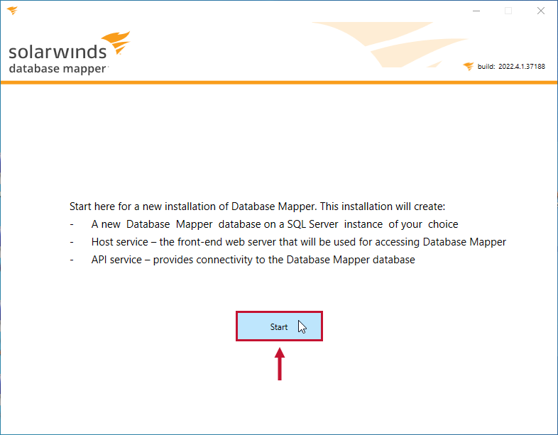

The Start here screen opens when you open the Database Mapper Configuration Utility for the first time on a new installation. The Start here screen details that the Database Mapper Configuration Utility will install a new Database Mapper database on your SQL Server Instance, a Host service, and an API service.
Select Start to continue.

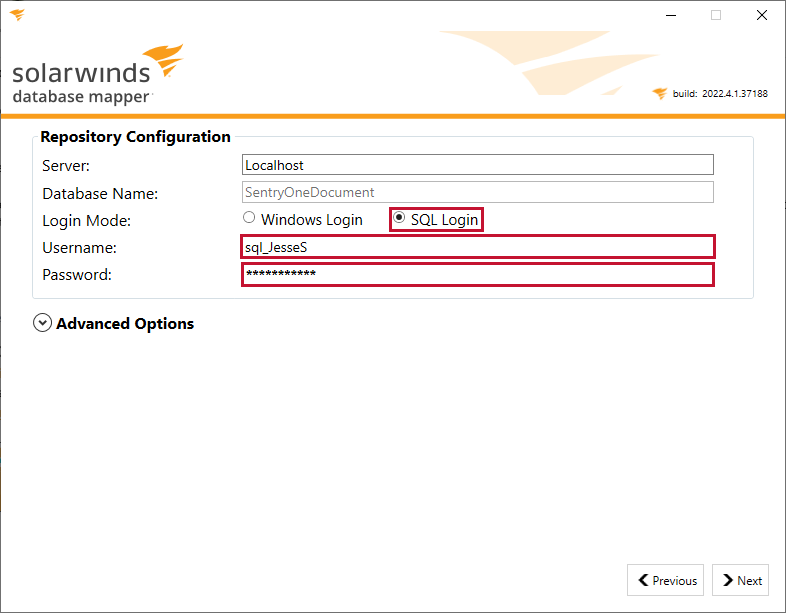

Configure your SQL Server connection that will contain the Database Mapper database on the Repository Configuration screen.
Option  Description
Server The Server name where Database Mapper software is installed.
Database Name The Database name for your Database Mapper software installation. Note:  The Database Name is SentryOneDocument by default.
Username The login used for the Database Mapper Remote Agent service.
Password The password for the Database Mapper Remote Agent service login.
Windows Login / SQL Login The Windows or SQL Server credentials for the server where Database Mapper Software is installed.

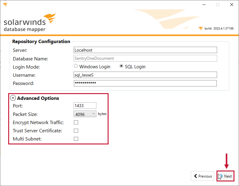

Advanced Options
Database Mapper Configuration Utility Repository Configuration Advanced Options
Select Advanced Options to open the advanced configuration options for your SQL Server that will contain the Database Mapper database.
Option Description
Port The port used to connect to your SQL Server that will contain the Database Mapper database.
Packet Size The network packet size for your Database Mapper database connection. Select an option from the drop-down list.
Encrypt Network Traffic Select the checkbox to encrypt network traffic.
Trust Server Certificate Select the checkbox to trust the server certificate.
Multi Subnet Select the checkbox to apply multi subnet to the connection.
Additional Information: For more information about the settings in the Advanced Properties:

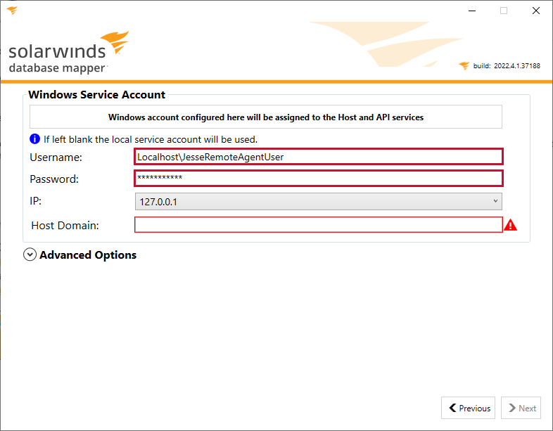

Windows Service Account
Database Mapper Configuration Utility Windows Service Account

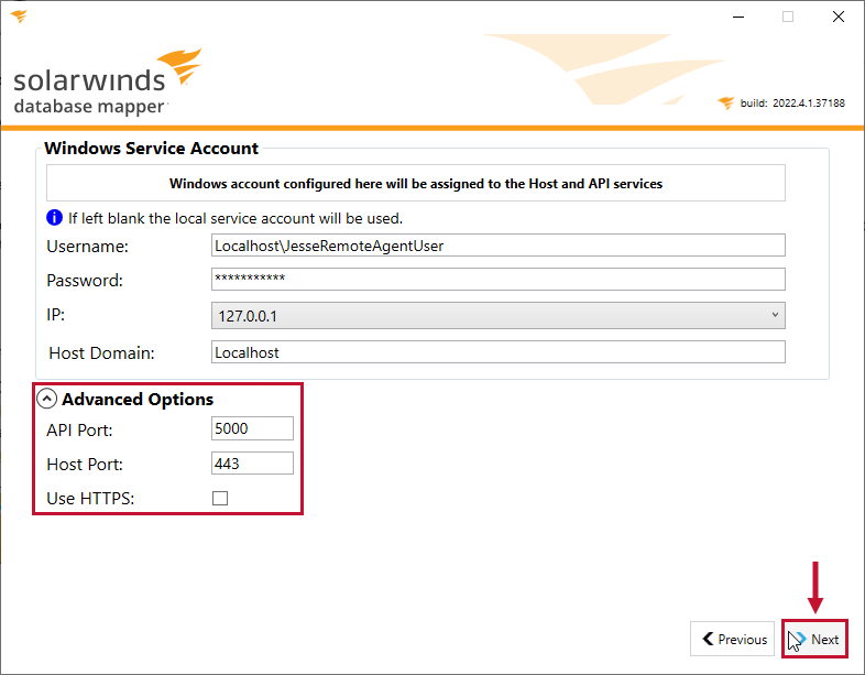

Configure the Windows service account that will be used with the Host and API services on the Windows Service Account screen.
Option Description
Username The username for the hosting service.
Password The password for the hosting service username.
IP
The binding IP address for your connection. Use the drop-down list to select an IP address.
Host Domain The friendly name (web server address) of the host domain.
Important:  The Host Domain field will determine your Database Mapper Web URL. For example, if your Database Mapper site will be connected locally with localhost like the example above, you will use localhost in the URL.
If you want your Database Mapper site to be accessible outside of the host machine, enter the host machine name. For example, if the host machine name is AppServer23, you would enter AppServer23 in the Host Domain field.
Advanced Options
Database Mapper Configuration Utility Windows Service Account Advanced Options
Select Advanced Options to open the advanced configuration options for your Windows Service account that will be used with the Database Mapper Host and API services.
Option Description
API Port The port used to connect to the API Service. Note:  The default API Port is 5000.
Host Port The port used to connect to the Host Service. Note:  The default Host Port is 80.

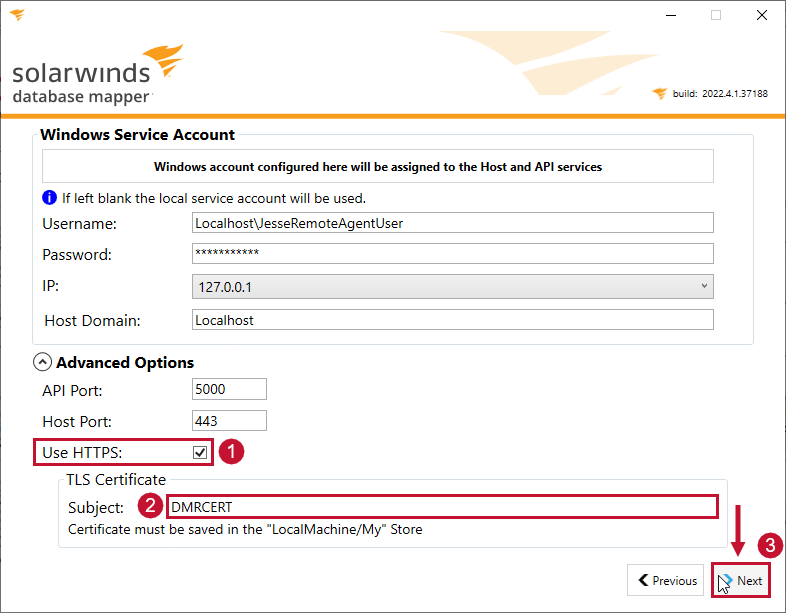

Use HTTPS Select the checkbox to Use HTTPs and enter a TLS certificate. Note:  The default Host Port if you select to use HTTPS is 443.
Use TLS
To use TLS for SolarWinds Database Mapper:
  1. Select the box next to Use HTTPS. Once selected, you'll see the TLS Certificate section.
  2. Enter the name of the certificate in Subject.
  3. Select Next to continue with the Database Mapper configuration.
    Database Mapper Configuration Utility Windows Service Account Use HTTPS TLS cert example
Success: You have enabled TLS for SolarWinds Database Mapper. Use HTTPS:// at the beginning of the URL to open it in your browser.

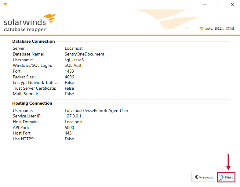

The Review screen displays your configured options for your Database Connection and Hosting Connection.

1. Open the Database Mapper Configuration Utility as an administrator.
2. Select Start to configure a new Database Mapper Software connection.

3. Enter your Database Server that will host the Database Mapper database.
Database Mapper Configuration Utility Repository Configuration enter server name
Note:  The database for Database Mapper Software is named SentryOneDocument. If you don't have a Database Mapper Software database, the SentryOneDocument database will be installed onto your Server.
4. Select the login mode to use for your database server connection, and then enter a valid username and password.Database Mapper Configuration Utility Repository Configuration enter server credentials

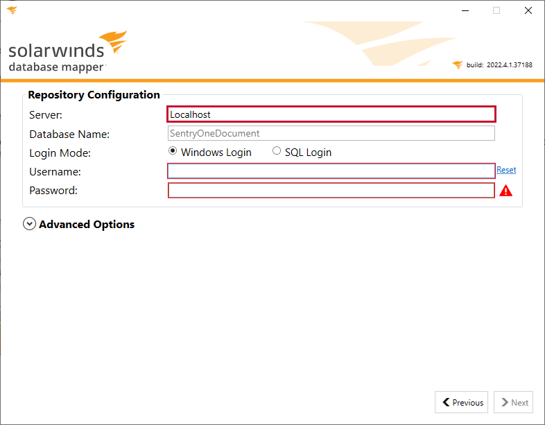

Note:  If you select Windows Login and don't enter a username, the Database Mapper Configuration Utility will use the Windows Service account by default.
5. Select Advanced Options and configure any applicable options for your database connection. Select Next to continue to the Windows Service Account configuration.
Database Mapper Configuration Utility Repository Configuration Advanced Options select Next
Additional Information: For more information about Advanced Options within the Database Mapper Configuration Utility, see the Advanced Options sections.
6. Enter the username and password that will be used for the Host and API services.Database Mapper Configuration Utility Windows Service Account enter service user credentials
Note:  The username should use the following syntax: <server\username>.
The DMCU will use the local service account if the Service user username and password are left blank.
7. Select the IP address you want to use from the drop-down menu and then enter the domain name (friendly name) in the Host Domain field.
Database Mapper Configuration Utility Windows Service Account select IP
 8. Select Advanced Options and configure any applicable options for your windows service account. Select Next to continue to the review screen.Database Mapper Configuration Utility Windows Service Account Advanced options select Next
9. Review the information you've entered for the Database Connection and Hosting Connection. Select Next to continue.Database Mapper Configuration Utility Database Connection and Hosting Connection review select Next
Note:  Selecting Next automatically installs the Host and API services.

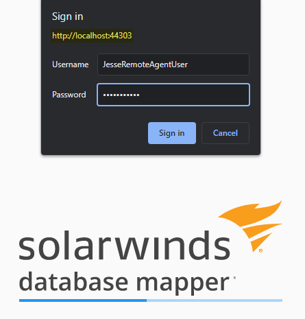

11. Select Launch to open your Database Mapper Software connection in your web browser. Note:  You can also select to copy the Database Mapper URL to your clipboard. Your URL will use the following syntax: http://ServerName:HostBinding or http://IpAddress:HostBinding.
Database Mapper URL http://ServerName:HostBinding example
Note:  In this example, our Database Mapper Software URL is http://localhost:44303 or http://127.0.0.1:44303. You will be prompted to login with your Integrated or SQL Server Credentials used for the Hosting Services account.
Database Mapper Windows Security prompt
Important:  If you selected the Use HTTPS checkbox, your URL will begin with https:// .
