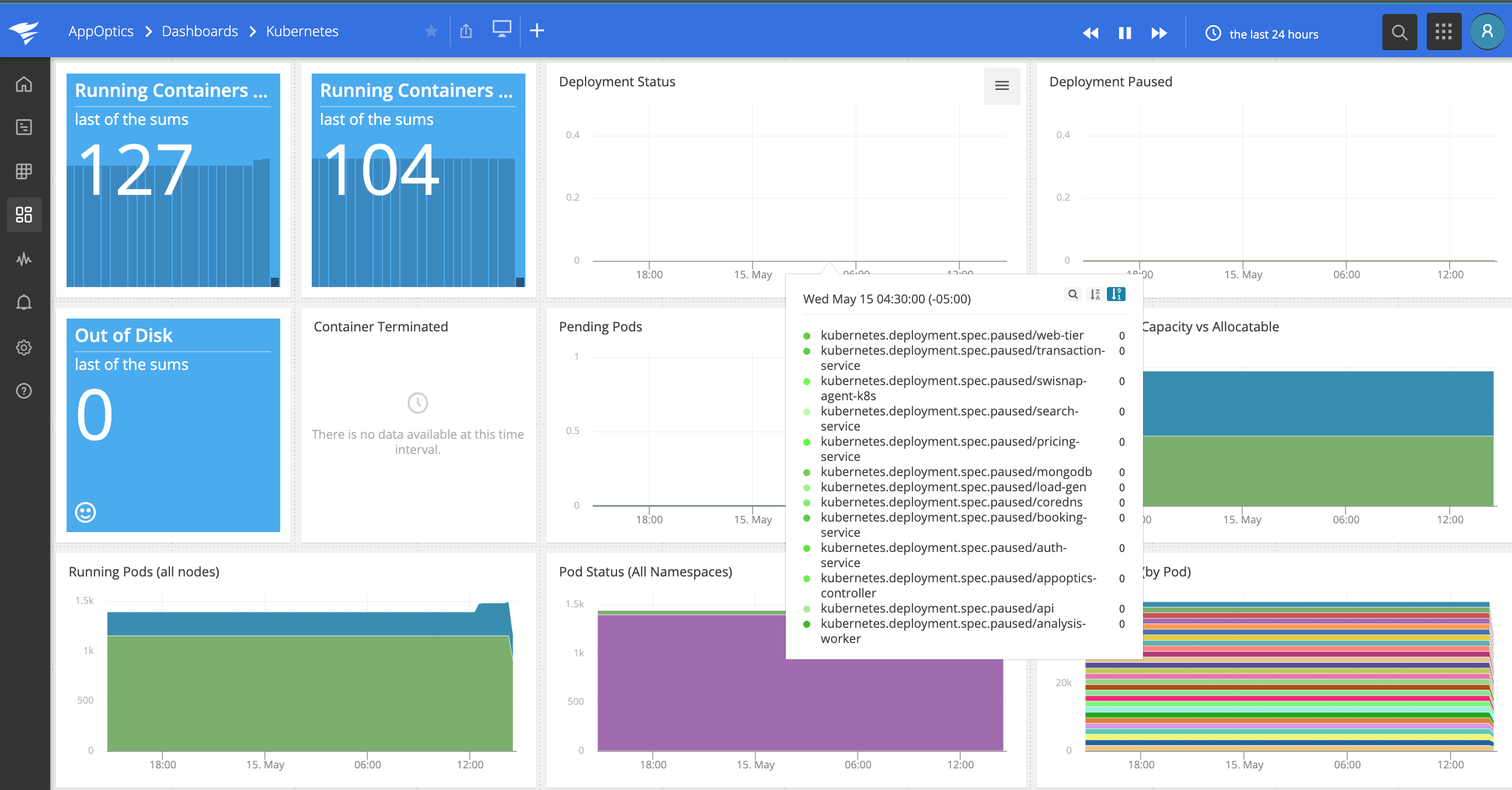

Dashboard
After you've successfully set up the SolarWinds Snap Agent, enable the Kubernetes plugin in the AppOptics UI and you should see data pour in. More about Charts and Dashboards.
../../../../../../_images/kubernetes_dashboard.png
When the APM Integrated Experience is enabled, AppOptics shares a common navigation and enhanced feature set with the other integrated experiences' products. How you navigate AppOptics and access its features may vary from these instructions. For more information, go to the APM Integrated Experience documentation.
